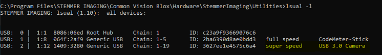

I’m using a USB3 IDS Camera : UI-3280CP-C-HQ Rev2
I’ve install IDS Software Suite + CVB-Driver-ids-uEye-cameras-x64
When i use lsual, i can see my camera (USB 3.0 Camera)
But when i open the Managment Console , i can’t see the camera in U3VDriver Manager or in Advanced Configuration

Hi @Didier
For clarification the camera you have is a generic USB3 device. It is not a USB3 Vision device.
With our GenICam implementation we support USB3 Vision Devices not generic USB3 devices.
This is why you can´t see your camera in the U3VDriver Manager, Advanced Configuration or the GenIcam Browser which we would prefer.
Installing the IDS CVB Driver you mentioned was correct. But this does not bring support with our GenICam implentation. This installs a separate VIN-Driver which he need to load e.g. in the Common Vision Blox Viewer for testing.
