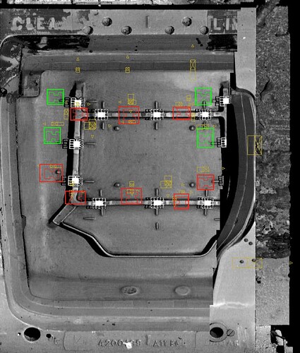

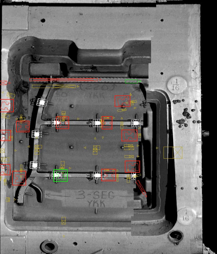

Since more than one year now, I use the stack 3 to take pictures on our main vision products. It use two AT (mostly C5 SCT) cameras that reconstruct huge carts to control components on it.
We set up the AT to take fixed size images with a maximum of profile (5400). We also open all Ethernet board parameters like Jumbo packets to there maximum. We set also the scsp packet size to it’s maximum.
With the stack two, no problem at all. When we use stack 3 we can see this :
when we should have this :
We also understand that when this happen, we got verry small pikes (in red in the image) contrary to the huge pikes that we have normally (in green) with the task manager :
When we switched from stack 2 to stack 3 or the inverse, no parameters are changed.
The stack 3 used a composite image to get data. Both camera are on the same Ethernet board, without any other element on it.
We suspect that either we get a improper network settings or a problem with stack 3 like bad uses or missing a parameters that need to set up ? Or have you any ideas ?
Hi @AxelDosSantosDoAlto,
With our experience of the new GenTL stack (3rd Gen stack) I expect no difference in performance or stability.
The first image clearly shows lost packets, which you also should see when checking for corrupt frames or Incomplete frames. if you want to do it programmatically.
I strongly suspect a setting which is different in these two setups. And the one which is set from CVB is the PacketSize. So this would be the first thing to check. Has the packet size the expected value?

For now, as far as I am in my test, I always have the problem (the images can be display here the time of the resolution of the problem, so no worries about it) sometime :
Beside the scsp packet size, on the ethernet board, we set up the jumbo packet to the maximum, the reception and transmission data to the maximum too.
As a reminder, we received N small images (20 profils or pixel in height) and we reconstruct the all images of 4900 profiles/ pixel in height. We set the CVB buffer to N = 4900 / 20 = 245 small images, for a production time of 8 secondes (each 8 secondes we get a trigger that inform us a new product is here to see). The internal CVB buffer are for now 245 * 3 =~750 buffer of 20 profiles for one camera. We use two AT C5 SCT cameras.
Hope those information will help you tell me what the problem is.

    If I interprete your images correctly, this happens not only once. At a certain point in the scan process (you seem to be scanning horizontally with the camera moving from left to right) the trigger might start stuttering, meaning we have a gate high which is interrupted for a short time exceeding the packet timeout. This happens with the next frames again and again leading to this staircase kind of blocks we see.
    This is just a rough guess but if you change the PacketTimeout to be indefinite OR monitor your trigger signal (accuracy of measurement method < PacketTimeout) we can validate if we see interrupts in the signal which have to be taken care of.
