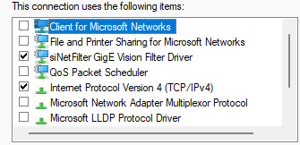

Set my PC’s port “Internet Protocol Version 4 (TCP/IPv4) Properties” to “use the following…”
(with the driver active and the IPv4 only)
then inside of the GenICam Browser I clicked on the “Ignore Subnet discover” to search for my device.

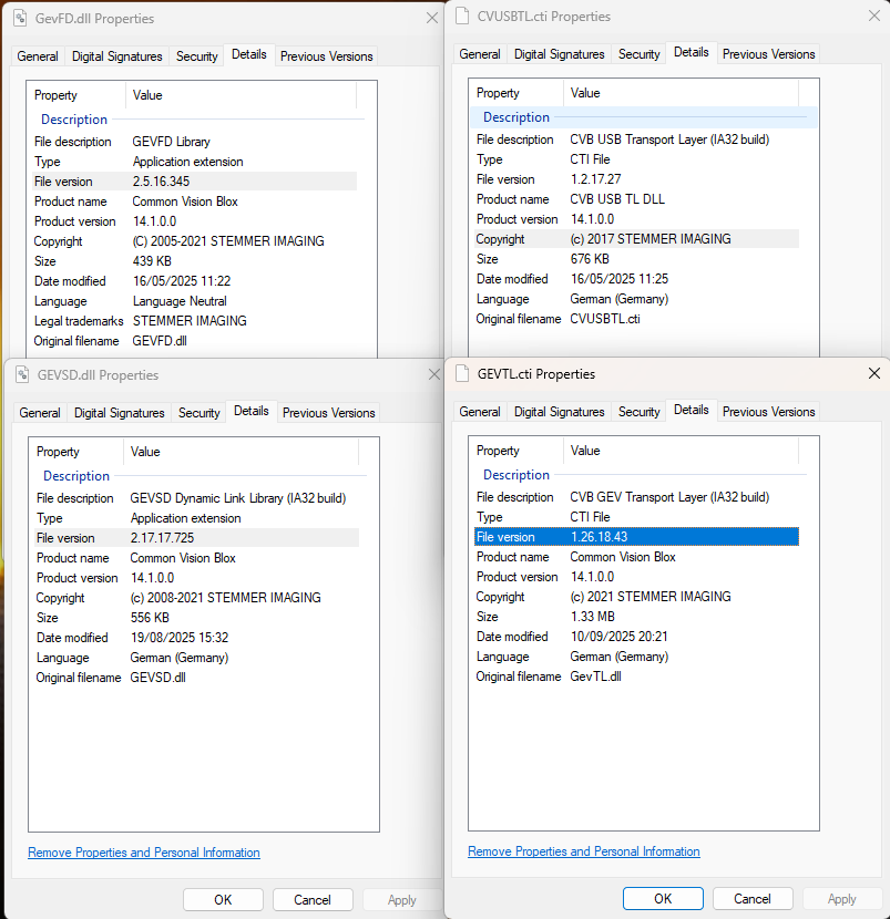

Could you tell us the version within the properties of GevTL.cti within %CVB%\GenICam\bin\win10_i86\TLIs .
Here is a screenshot of the properties window for each of the items within my:
C:\Program Files (x86)\STEMMER IMAGING\Common Vision Blox\GenICam\bin\win32_i86\TLIs
Folder
