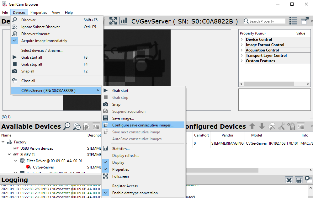

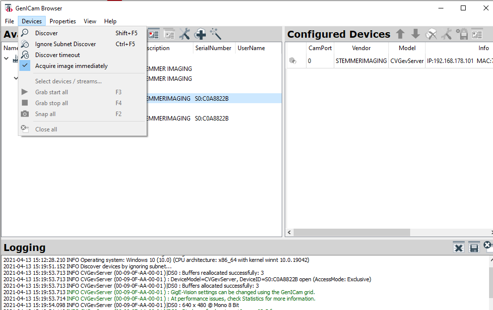

Did you open the camera? Otherwise the option is not available as seen in this screenshot:
With the camera opened, it should look like this:

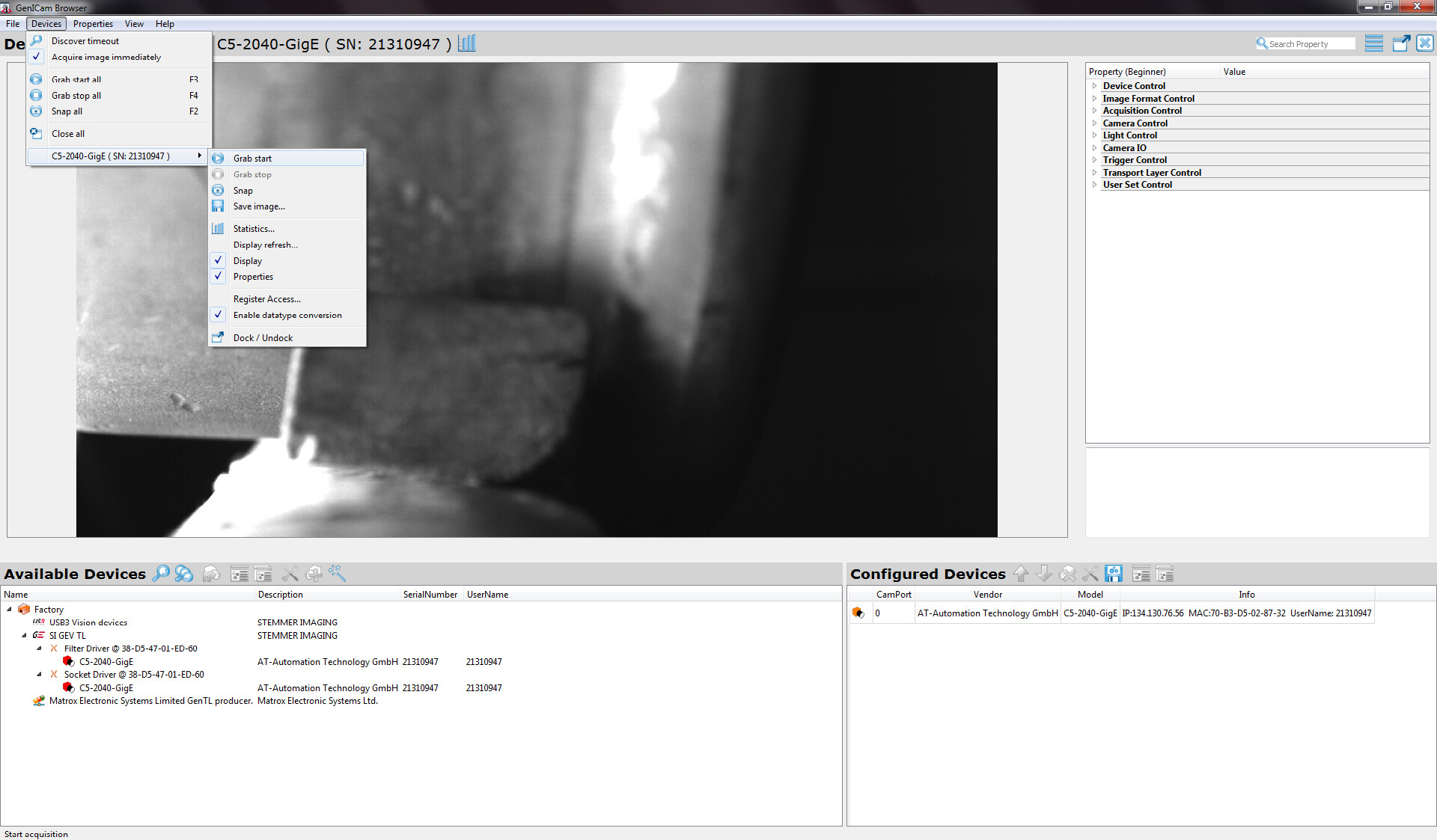

Yes, I have opened the camera. It’s like this:
Looks like a rather old version of :cvb:. Which one is installed on your system?
You can find the latest version for download here in the forum.
