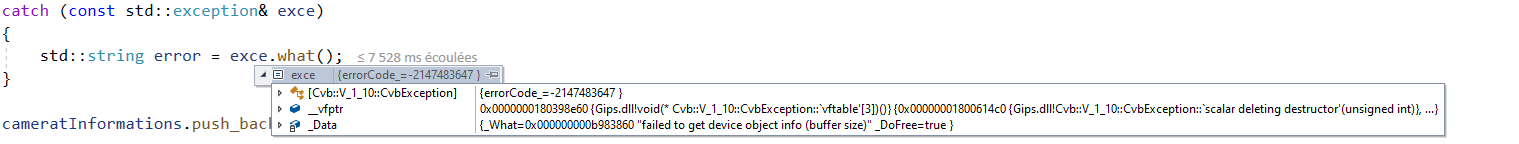

I get a lot of element from the discoveryInformations, and somehow I get sometime a device that return an c++ exception at the line :
data.AccessToken = discoveryInformations[i].AccessToken();
I get two pictures to help :
and
Do you know what can do that ? I try this code on 6 software-setup-the-same computers, all with a recent version of CVB 14.01.01, and two of them have this error.
