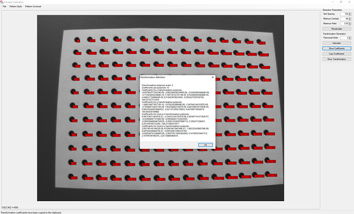

I have the code from https://forum.commonvisionblox.com/t/getting-started-with-cvb-net/246/6 on how to acquire images from camera.
The fish eye effect affects the accuracy of results. So i would like to calibrate it before acquiring. I found there is a cvb tool auto calibration like this:
How can i apply the transformation coefficients to achieve calibration before StreamImage starts?
Or is there any other methods?
I really need this help. Thank you anyway!
Best Wishes
Road
Good morning @Road,
I guess, what you are looking for is the transformation function as shown in Tutorial\Foundation\VC\VCNLCalibration (which you can find in the CVB installation). The transformation functions are part of the foundation package. I hope, the example will help you. Further information on the different APIs can be found in the Online Reference.
